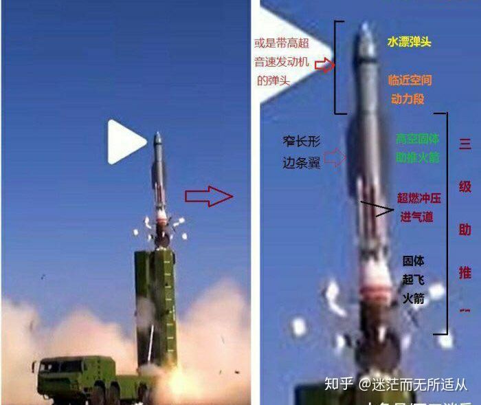

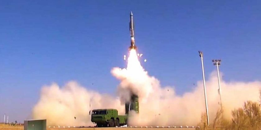

Do we know the range of the DF-100? Because if it’s over 1500km, it maybe a great option for Pakistan as a SLBM, considering its dimensions. A modified Hangor Class SSK could carry 6-10 of these and hold a considerable part of India China within its range, a similar modification as the 10 cell Amur 950 Class SSK designs from Russia. A single warhead packed with decoys could be a considerable threat, if this missile is also maneuverable into the terminal phase.
Do we know the range of the DF-100? Because if it’s over 1500km, it maybe a great option for Pakistan as a SLBM, considering its dimensions. A modified Hangor Class SSK could carry 6-10 of these and hold a considerable part of India China within its range, a similar modification as the 10 cell Amur Class SSK designs from Russia. A single warhead packed with decoys could be a considerable threat, if this missile is also maneuverable into the terminal phase.
DF-100 seems to be a near-hypersonic cruise missile flying near space orbit as it is officially named as "supersonic cruise missile". Based on the following images I found on Internet, I guess it has a nose intake, subsonic ram jet and a maximum speed under Mach 5. Some other sources indicated that DF-100 is China's first generation missile with high manoeuverability flying near space. Since it is allegedly using the breathing, subsonic ramjet and hence can not fly over Mach 5, it was rumoured to be replaced by DF-17.
View attachment 767227View attachment 767228View attachment 767229
So it could be used as a SLBM. What is the range?
