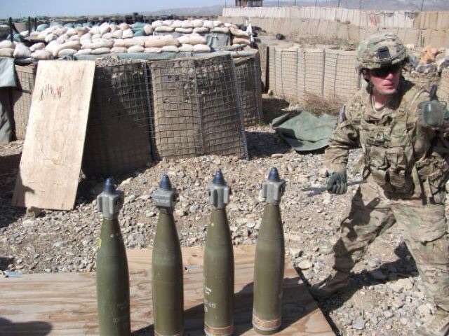

The PGK fuze screws into the fuze well of 155mm high-explosive artillery projectiles. It uses a GPS to determine its position relative to the target and uses small aerodynamic fins to perform in-flight course corrections along its ballistic trajectory.

Once of the engineering challenges, Jones said, was to miniaturize the fuze and GPS guidance system to fit inside the fuze well, with no other modifications to the 155 rounds. Ultimately, it weighs about three pounds, while the "dumb" fuze weighs two pounds — the difference being the fins and alternator.

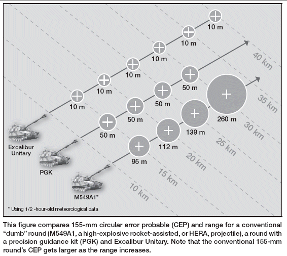

The accuracy of area fire weapons is based on circular error probability (CEP), the imaginary circle around a target within which a round would fall. PGK, according to the company, reduces artillery dispersion of more than 200 meters to less than 30 meters.
"One of the reasons the program [receives] criticism is that it was in development a long time, but the Army saw the ability to go past 50 meters, the original threshold goal," Jones said. "In the end, we achieved, or exceeded the Army's goals."

I like it. PGK would complement Excalibur.
shame we don't got a SPH that has MRSI capability. can you imagine 6 155mm shells landing within 50 CEP of you.
