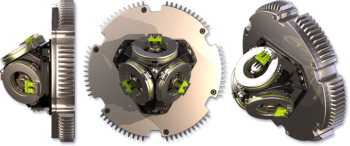

It look like something Doc Brown would be working on in his garage, but it is absolutely one of the most essential and sensitive technologies found on many military and some civilian aircraft today: The Ring Laser Gyroscope.
Introduced in the mid 1960s and developed rapidly from then on, the Ring Laser Gyroscope has taken the place of many larger and more complex mechanical gyroscope systems. In comparison to their predecessors, Ring Laser Gyros can be built much smaller, they do not resist changes in direction, are totally frictionless, have low power consumption, and feature almost no moving parts, thus they are incredibly reliable, while still providing adequate accuracy.
Ring Laser Gyroscope's small size has also made them particularly well suited for tactical aircraft, both manned and unmanned, and weapon systems that once had to rely on much bulkier inertial navigation systems made up of accelerometer and mechanical gyroscopes. These include bombers, surface combatants, satellites and submarines. Additionally, this technology has migrated to the commercial marketplace, and many modern airliners and ships also feature RLG technology in their navigational suites.
Today, modern inertial navigational suites found on some aircraft, submarines, ships and spacecraft use Ring Laser Gyroscopes as part of an integrated Inertial Navigation Systems (INS), and in some cases, fly-by-wire flight control systems and targeting pods use them as well.
Inertial navigation systems with integrated GPS can pair gyroscopes, and in many cases Ring Laser Gyroscopes, and accelerometers with a GPS receiver system. Software within the system cross-checks the readings of each discreet navigational sensor source, and possibly other sources such as radio navigational beacons, flight data such as airspeed and attitude, and doppler and radar altimeter data to come up with an 'agreed upon' position.

Ring Laser Gyros' lack of moving parts and small size, such as the Honeywell HG1900 IMU which weighs under two pounds, and the HG1700 IMU which weighs under a pound, make them ideal for integration on guided munitions. The Joint Direct Attack Munition (JDAM),Paveway IV dual mode laser guided bomb, use these units, along with GPS, to execute incredibly pinpoint attacks on their targets. Also, the inclusion of a competent INS system along with GPS means that if a GPS signal is jammed or lost, the munition still has a high-probability of effecting its intended target.

The Irony is this is nothing more than riding a bicycle, after all it is based on the principle of balancing the bicycle.
Right!
The angulur momentum of the turning bicycle wheels makes them act like gyroscopes to help stabilize the bicycle. This gyroscopic action also helps to turn the bicycle.
But I would say Ring Laser Gyroscope uses Doppler principle to measure differences in laser light beams. :)

I thought Ring laser gyroscopes exploits sagnac effect to its advantage and I dont see any solution in ring laser gyroscopes
ACE OF THE AIR said:
Moreover can the light beams be controlled i.e increase or decrease the number of light beam frequency because doppler frequencies can be reduced or increased to find the target range and size.
well rather than detecting time of travel differences of the laser beam split into 2 beams inside the RLG, the detectors measure differences in frequency, using the Doppler principle which is the basis of range-finding radars. The beam that is traveling in the direction of rotation of the platform has a longer distance to travel and thus a lower frequency while the beam traveling against the direction of motion has a shorter path and a higher frequency. The difference in frequency is directly proportional to the rotation rate.
would indicate that it is going to work at a constant speed at all times. Hence this is only going to work on 1 dimension (the horizontal plain.) Wings Levelled flight characteristics.

Well I might be wrong but as far as I know its the INS which has the larger role to play, each INS has 3 accelerators and 3 ring laser gyroscopes and they 're oriented along each of the three axis (x,y,z) of the airplane, so it does consider all the 3 dimensions.Initially only a coarse vertical is established. And once vertical is established, the laser gyro senses earth rate components, which are used to establish the heading of the airplane. As the alignment continues, both the vertical reference and the heading determinations are fine tuned for maximum accuracy.
And its the software that does all the computations, including compensations, navigational calculations, and coordinate transformations. Gyro and accelerometer outputs are compensated for sensor bias, scale factor, misalignment, and thermal changes. The compensated signals are used in computing airplane pitch, roll and heading relative to the local navigation coordinates.
The inertial system display unit (ISDU) provides pilot interface with the Inertial reference units. The display of track angle, ground speed, present position, wind direction and speed, heading and system status is available in ISDU.
