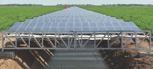

Baluchistan is hotter as compared to other Provinces. Taking a look on how India is installing solar panels in it's areas (on canals). It was a very good step.
I just want to say they must do something to overcome heat and reduce maintenance cost.
It is my own experience that if you are not serious in cooling the panels then you can't get smoother outcome.
It is my own experience that if you are not serious in cooling the panels then you can't get smoother outcome.View attachment 566812
It's cool!
Yes you are correct... power output from solar panel decreases as its temperature rises.
