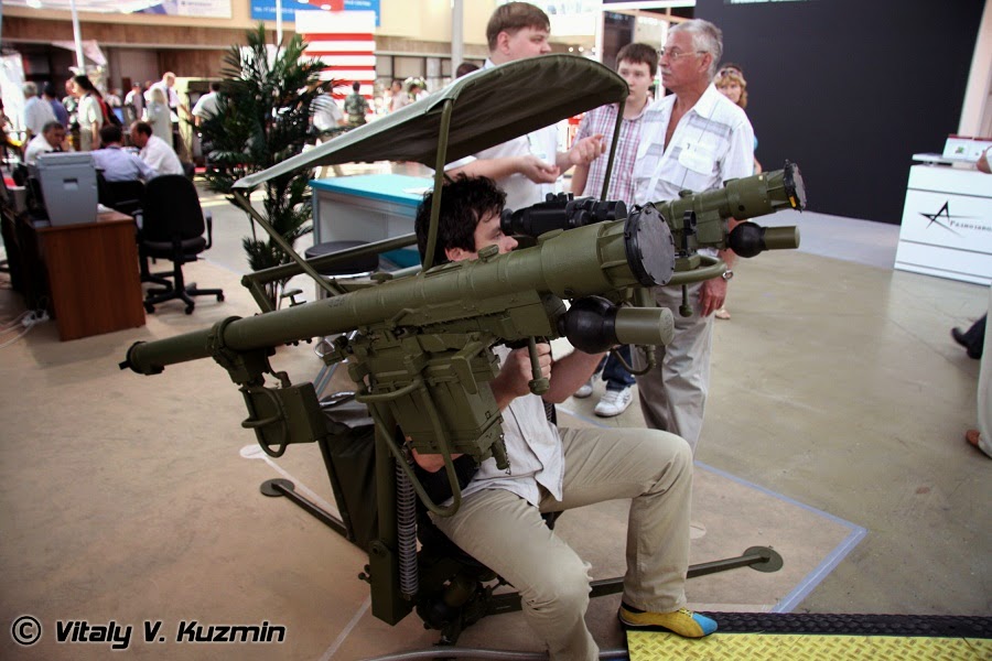

Igla-S
Twin tube Igla-S VSHORAD
As of now the Indian Army uses the Igla-S the Russian MANPAD which is a battle proven system under the Indian condition earlier our MANPAD crew shot downed two Pakistani helicopters using the Igla-S. Igla is a cheap, easy to maintain and use system. It's a highly portable, very effective system compared to other contenders. During the trails in summer 2012 Igla failed to hit the targets where it shot down only one out of four targets, during the sea trails the system failed produce any impressive results, in the high altitude tests the Igla's failed to intercept any target.
The Igla S can engage targets at the Altitude upto 20000 feet, where as it's operation range remains classified.

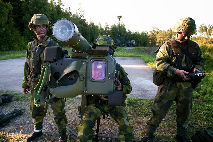

SAAB RBS 70 NG
SAAB RBS 70 NG, surveillance radar in the foreground
The SAAB offered the RBS 70 next generation variant which is claimed to be unjammable. It uses the Laser beam for Target acquire and Lock function. During the SAAB evaluation in Sweden which exhibited to seventeen country's defence officials the system scored a hundred percent kill probability. Unlike the IR guided missiles which are easily jammable, the RBS 70 uses the Laser beam riding which can't be jammed in open area's. The RBS 70 NG range is classified but according reliable sources the missile can engage a target up to 8 kilometers away flying at an altitude of 16000 feet . Unlike other systems the RBS 70 needs a surveillance radar where three to five stations can operate under one Radar.
The RBS 70 NG can be used in any tough conditions, the system will work under stand alone mode too according to SAAB reports.

Igla-S

SAAB RBS 70 NG

@Major Shaitan Singh: The statement "while compared to IR homing the Laser homing have disadvantages like Most of the Fighter jets have RWR (Radar warning Receivers ) and MAWS sensors" is wrong.
RWR alerts for both radar-homing missiles and surveillance radars, and regardless of IR-homing or laser guided missile, this is not a problem. However, both the IR-homing and laser guided systems are dependant on cuing from a radar in order to be able to engage a fast approaching jet.
Concerning MAWS, these detect the UV-light and IR-light from the motor of the missile, and this signature is similiar regardless of the missile guidance, i.e. if it is IR-homing or laser guided.
Laser warning systems on fighter aircrafts reacts more on laser range finders, used for instance with air defence guns. A laser guided missile have much lower laser output effect, only what is needed to receive at the back of the missile, and a laser warning system will not react to the laser guidance until it is too late.
There are however two other counter measure for aircrafts which is very effective against IR-homing missiles like Mistral and IGLA, but which a laser guided system like RBS 70 NG is unaffected by.
First there are flares, which are automatcially ejected when the MAWS detect a threat. And modern systems ejects so many flares that the IR seeker isn't able to handle all of them, and hence loose the real target. Also, trying to lock on a target when there are flares around is quite impossible.
The second, and most modern counter-measure system which is getting more and more common, is the DIRCM (Directed IR Counter Measure). This is also cued by the MAWS and directs a laser on the IR-seeker, blinding the seeker completely.
If one is concerned about counter measures the absolutely best solution is the RBS 70 NG.
